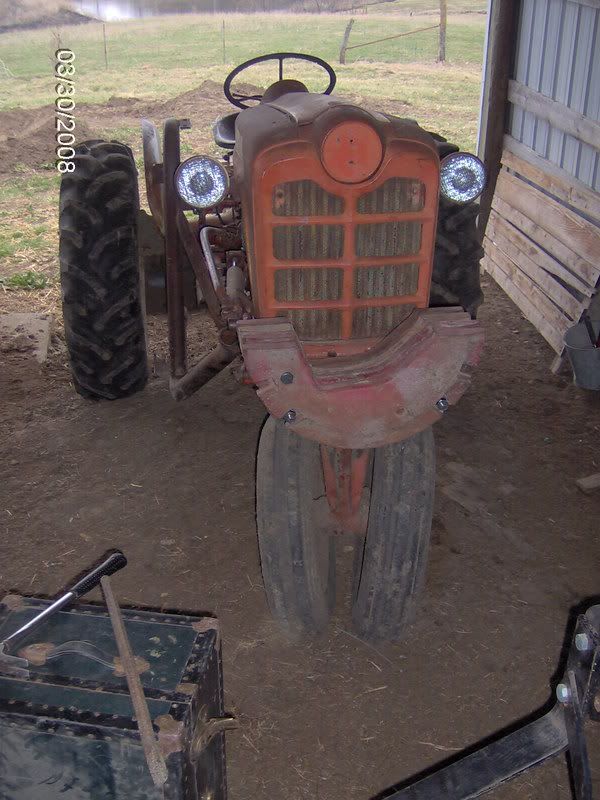

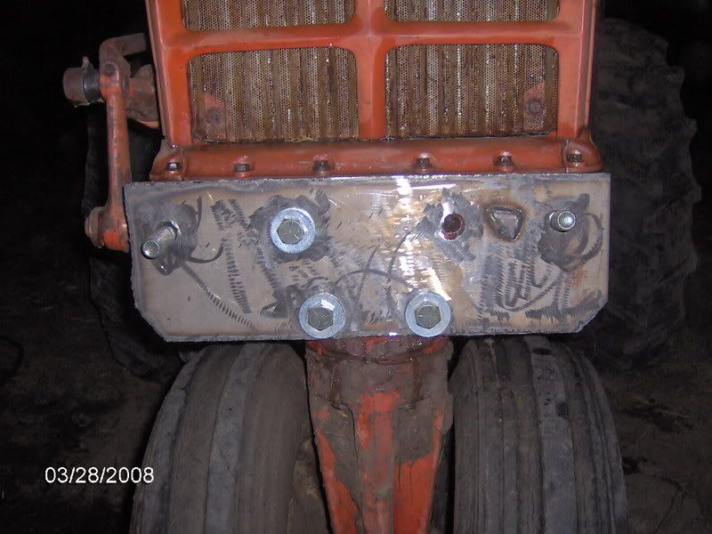

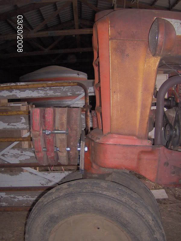

Good evening friends,
I just wanted to post some pics of the front weights I put on the 971. I'm getting ready to do some brush cutting on some steeper timber ground. Just wanting to keep a nice walking path for us to go explore and see some of God's creation. Anything questionable I will traverse downhill, but the weight should help when mowing uphill. I believe these are old IH wheel weights, each 75 lbs. The plates were cut from 1/2" flat stock and holes torched. On a side note, I used my tractor to pull the base of an old 10' dia. satelite dish out on Friday. Had to dig next to it and get it mostly sideways. Thought I was going to have to sledge hammer it down some, but it came out. Probably weighed 1000# or more. Have a great week. Will be working on wiring the headlights next.

souNdguy said: (quoted from post at 08:34:50 03/31/08) Ahh.. I see it now.. for some reason it dind't show at first.
same question on the bolts though? threaded blind or thru holes.. or smooth thru holes?

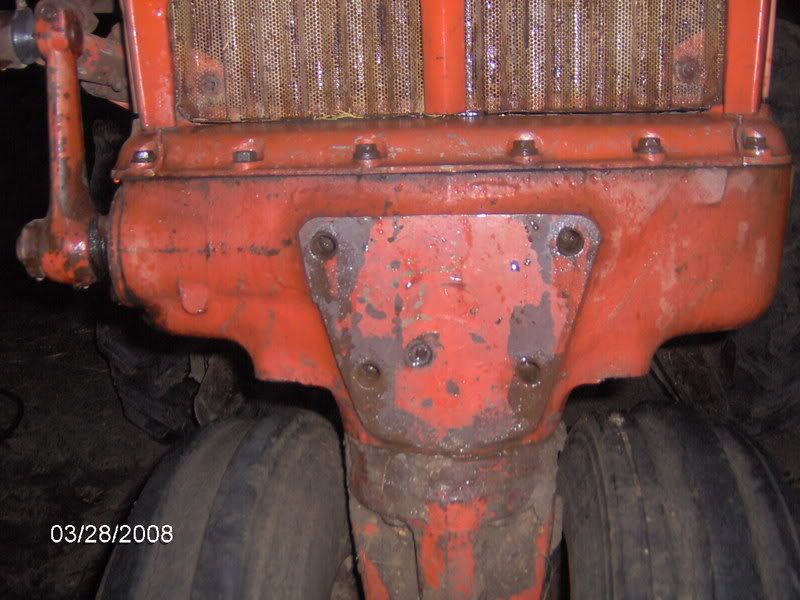

Good Morning Soundguy,
I like the looks of your trike. The holes are threaded blind about 1" or little more deep. I used grade 5 bolts, havn't bounced through the pasture yet, but it seems pretty tight. I'm going to get a long bolt and run it through to top holes to bolt all the weights together as well. The one pic shows a bolt in there, but it is too short, I was just using it to hold the last weight and help me line things up.

 Re: 971 front weights in reply to NWMO 901 SOS, 03-30-2008 20:22:13
Got a pic of the fron bracket itself?
I havn't probe dthe holes in the front bolster.. are they blind threaded.. or thru holes so you can nut the back of a bolt?

That should keep the nose down. I'm going to post some pics of the suitcase weight bracket for my 5200... if it ever gets done. By drilling the mounting bolt holes to match the pattern and size for the hundred series row crops, it would fit them, too.
