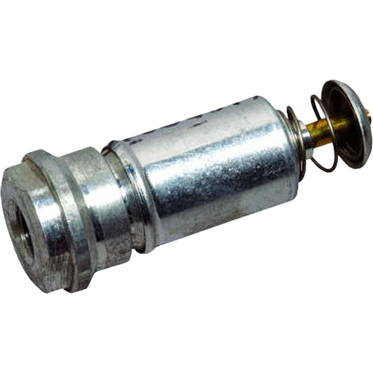

Curious, how are you measuring the voltage with the gas valve connected, is yours an older unit with open connections, or do you have an access adapter?
Or, Honeywell sells a tester that is basically part of the innards of a gas valve... you connect the tester with the pilot lit and depress the test button, which will remain latched as long as the pilot is lit, IF the thermocouple is not intermittent.
