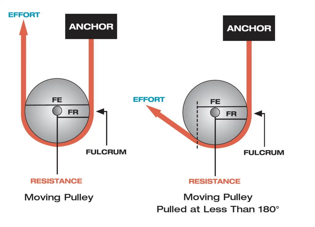

One pulley on the resistance/object to be moved and effort being the winch, the anchor end can be near the winch or off to the side.
But angle between the two cable runs will decrease the mechanical advantage of 2:1 to nothing more than a redirect pull as FE is less and less.
